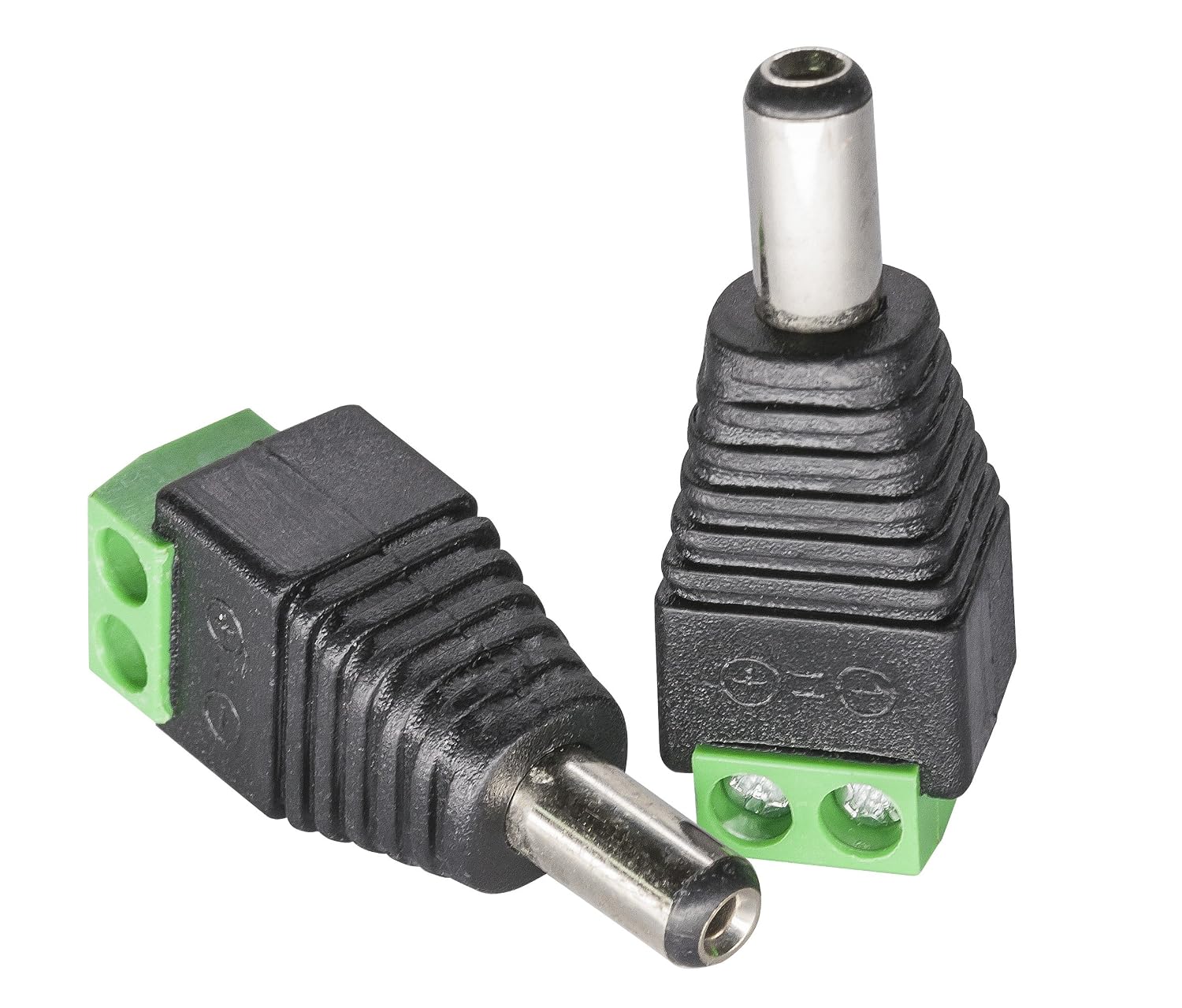

For ease of connection to a power supply like you linked, there are many, many choices out there but these jacks with screw terminal make simple work and are cheap enough https://www.amazon.com/gp/product/B01M1YA9ST
